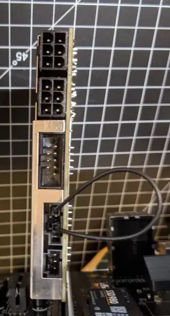

Fortunately, both of these can be worked around without requiring the manufacturer to provide a BIOS update. For the first issue, the add-in cards have GPIO that, if bridged, will force power the Thunderbolt controller. On the GC-Titan Ridge Rev 2.0 card, the appropriate pins to bridge are pins 3 and 5 (as counted from the bottom/left). Here's a picture of the correct pins to bridge. On other cards, the pinout of the GPIO may be different. Make absolutely sure that your card matches before attempting this, since incorrect bridging may damage your device. (Of course, never try to do any bridging while the device is powered on).
                                                            Bridge these pins
Once this is done, if you boot the server, the thunderbolt controller should show up in PCIe:
