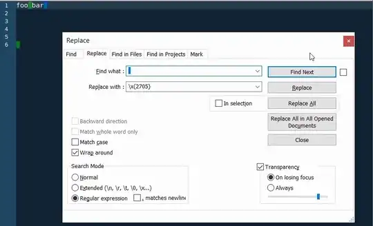

Workaround 2
Another workaround is to use find and replace to insert the checkmark character.
  • Press Ctrl+H
  • Find what: (a space)
  • Replace with: \x{2705}
  • Search mode: Regular expression
Unicode character in Notepad++ via Find and Replace
