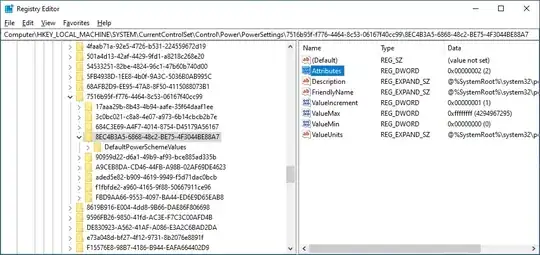

Open the Registry Editor by clicking start and type regedit.
Navigate to HKEY_LOCAL_MACHINE\SYSTEM\CurrentControlSet\Control\Power\PowerSettings\7516b95f-f776-4464-8c53-06167f40cc99\8EC4B3A5-6868-48c2-BE75-4F3044BE88A7. Double-click Attributes and change the value data from 1 to 2.
Registry Editor

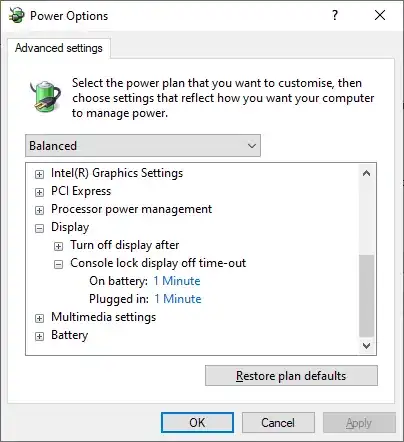

Click start and type edit power plan, open it then click Change advanced power settings.
Expand Display then you should be able to see the Console lock display off time-out setting.
Power Options
Change this to whatever suits you. 0 for never.
