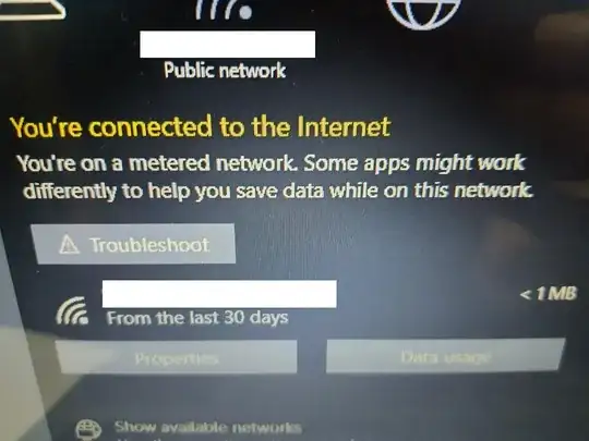

Now everything works fine but to every Wi-Fi that I connect to, shows the no internet error:
Did some basic troubleshooting and it lead me to this error: Wi-Fi doesn't have a valid IP configuration
https://imgur.com/a/JELlelh
