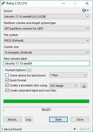

Rufus to make bootable USB's from ISO's. I think it was written by someone just as frustrated with ISO=->USB creation as you are at the moment.
enter image description here In my own experiencs when UNETBOOTIN failed, it was always Rufus that worked and became my sole bootable ISO --> USB maker.

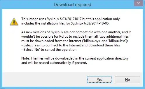

It's fast, it formats the USB drive for you and it has superb boot loader detection and also self updates itself or just versions of Syslinux if it detects a possible incompatibility.
I would say that this would work, I have seen it work on a couple of Linux distros. Here are Linux Instructions (not sure for what distro exactly, I dont do much with Linux), and here are Windows Instructions.
