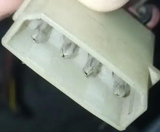

In my PSU, the said PATA connector doesn't look like the above PATA connector in any way. It looks like the following, just like a MOLEX connector, which match my older MOLEX cable in shapes & sizes.

"Molex connector" is actually a rather imprecise term, since the Molex company makes many, many different connectors. Including the main 24-pin ATX motherboard power connector! And companies other than Molex also make the connector you know as a "Molex connector", notably AMP but also many unbranded/generic ones are also available.
The 4-pin power connector that is commonly called a "Molex connector" is really more a general purpose peripheral power connector that delivers 12 V and 5 V power. It was most commonly used with pre-SATA hard drives, which are nowadays referred to as PATA (previously called IDE) drives.
Therefore, a power connector referred to as a "PATA" or "IDE" power connector is likely to be a "Molex 4-pin power connector" or "peripheral power connector" and looks like your latter pictures. Despite the different names, they are the same thing.
Your first pictured connector is actually a PATA/IDE ribbon data cable. Not power.
The ATX power supply specification actually refers (§ 4.2.2) to them as a "peripheral connector", specified as "AMP* 1-480424-0 or Molex* 15-24-4048 or equivalent". Note that AMP and Molex are two different manufacturers, and those are just part numbers.
Note also that the main 24-pin power connector (§ 4.2.1) is specified as "Molex* Housing: 24 Pin Molex Mini-Fit Jr. PN# 39-01-2240 or equivalent" -- another, different, "Molex" power connector.

  • So connector at image 4 should connect with image 3? – AL-zami Sep 26 '21 at 17:01
    @AL-zami They look compatible, yes. What is the second one connected to? Note that there are current capacity limits, and some applications (e.g. peripheral 4-pin to PCIe) may start a fire. For any high-power application, GPUs in particular, you should always use a direct cable from the PSU without any additional adaptors or connectors. For higher power GPUs you may even need two or three independent cables from the PSU, rather than daisy-chained connectors on a single cable. – Bob Sep 26 '21 at 17:29
  • The white molex peripheral is connected to a casing fan which is not in use for many years. But it has branches consists of a single sata connector. It was handy as my old psu was mostly molex (only 1 sata). Now i don't really need it as my new psu has 7 sata power connector.Wanted to connect the fan to my new psu just to check if this fan still works or not! – AL-zami Sep 26 '21 at 21:56
  • @AL-zami Ah yes, old uncontrolled case fans do often use that connector. You should be fine to connect it up that way if you want; fans are rather low power devices. Whether you use the SATA power or peripheral power connector doesn't really matter, use whichever is more convenient and maybe looks neater in your case. Personally I don't like using the peripheral connectors because they can be a bit hard to unplug if there's a poorly sized/fitted one. P.S. more modern fans tend to be temperature-controlled and connect to the motherboard, which also lets them run quieter when the system is idle. – Bob Sep 27 '21 at 03:39
