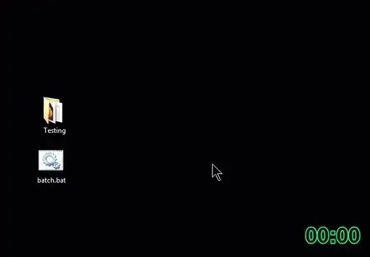

I assume only the png files that have a *.dat file associated with them should be renamed. You have to drag and drop the folder where the *.dat & *.png files are to the batch file...
@echo off
set String=_banana
if /i exist "%~1\" (set "Folder=%~1") else (exit)
pushd "%Folder%"
for /f "delims=" %%a in ('dir /b *.dat') do For /f "Delims=" %%b in ('dir /b "%%~na"*.png') do call :Rename "%%~na" "%%b"
exit
:Rename
set "Part1=%~1"
set "Part2=%~2"
call set "Part2=%%Part2:%Part1%=%%"
ren "%~2" "%Part1%%String%%Part2%"
goto :EOF
In this example the dog_cat PNGs are not renamed because they don't have *.dat file that have part of the name associated with them.
