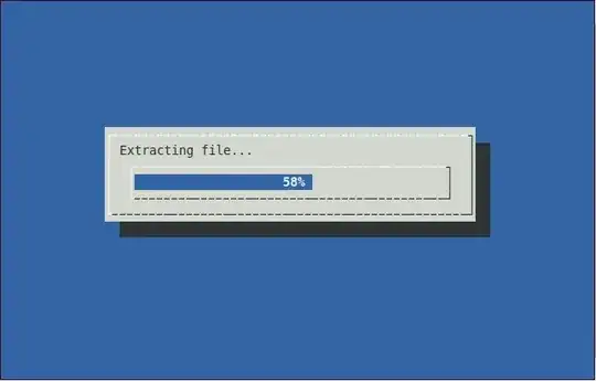

35
better progress bar..
apt-get install pv dialog
(pv -n file.tgz | tar xzf - -C target_directory ) \
2>&1 | dialog --gauge "Extracting file..." 6 50
Mr. Black
  • 465
    This is works for extraction, but you still need to do one of the more complicated commands for creation (which was the original question). It could still be combined with those; it's just more complicated. – Daniel H Aug 09 '14 at 05:05

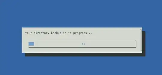

bzimage
better looking progress bar
Install the dialog and pv commands with
sudo apt-get install dialog pv
and then execute tar like this
(tar cf - /folder-with-big-files | pv -n -s $(du -sb /folder-with-big-files | awk '{print $1}') | gzip -9 > big-files.tar) 2>&1 | dialog --gauge 'Your backup is in progress...' 7 70
