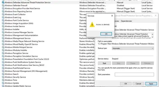

then I tried to check the services for the Windows defender advanced and firewall services but found them set to manual and disabled respectively, whenever I try to start it I get this error
Window Defender Advanced Threat Protection Service started and then stopped
whenever I try to switch it to automatic, it tells me Access Denied though I opened services as Administrator and I'm using an Administrator account.
Access Denied
