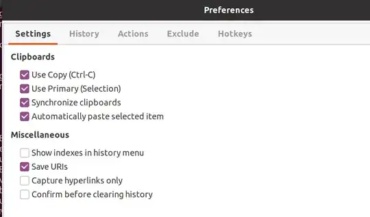

I went down the rabbit hole on this one. I failed to get autocutsel and parcellite to do what I wanted. I thought the problem might be Wayland, but Ubuntu says it is using X11.
I installed clipit, ran it, and opened preferences. I proceeded to check a bunch of boxes without knowing really what they did. enter image description here
Now everything that I select anywhere gets copied to the clipboard. And that's just fine. For now. I put clipit in the Startup Applications, and added -n so its icon is hidden. enter image description here
Problem solved. For now.
