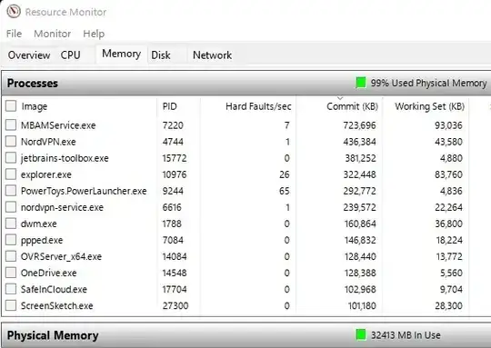

Did not notice this issue after upgrading to Windows 11 a couple of months back, but recently my RAM was 99% used several times and remained at 99% used even after closing all running programs other than background apps. Needless to say, computer became unresponsive and I had to reboot to return RAM usage back to normal.
Here is the Task Manager screenshot:
Task Manager
I opened up the Resource Monitor and none of the running tasks were using inordinate amount of memory:
Resource Monitor

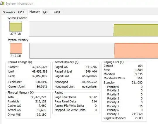

Process Explorer Sys Info provided more details than Resource Monitor but still nothing gave me a clue what exactly is happening here and what is taking up all that memory:
Any idea how to figure out what exactly is eating up all that RAM when this happens next time?

  • [You will have to use poolmon to diagnose a memory leak.](https://superuser.com/questions/949244/windows-10-high-memory-usage-unknown-reason/949246#949246). I would say the conclusion to that possible duplicate applies to your case given your using 30 GB of non-paged RAM – Ramhound Feb 08 '22 at 01:36

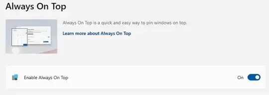

I believe I just caught the culprit and it is PowerToys Always On Top feature. I noticed my computer was slow and opened the Task Manager to find PowerToysAlwaysOnTop process using some CPU time and although the memory used was displayed as 1 MB as soon as I killed it my memory used dropped from 98% to 18%.
I disabled that feature of PowerToys and will update this reply if memory leak happens again while the feature is disabled.
