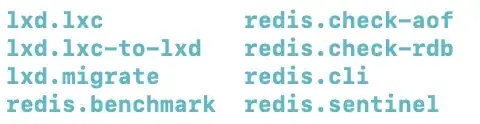

But my Redis is still version 6 and folder /Snap/bin looks like this (there is no redis-server command)
So it seems like Snap installation didn't replace existing Redis Server 6 installation.
