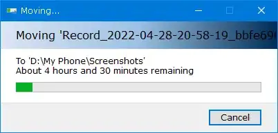

Please help, I need to transfer 148GiB worth of data from my Android phone to a computer.
My phone is Oppo A96 and it has run out of space:
It is filled screen recording videos, and they collectively take 148GiB of space, and I am going to move the files to my 4TB HDD (3725.29 GiB capacity), so that I can free up the space, and I can edit and compress the videos before I post them to my Youtube channel.
Of course I have a USB data cable, so I inserted one end of the cable to the phone and the other to a USB 3.0 port on the computer, to connect the phone to the computer, and selected "Transfer Files" in the prompt, and started copying the files using Windows Explorer:
It is taking ages.
It takes more than 4.5 hours to complete the transfer, I have cancelled the operation, I can't wait 4.5 hours just for the move operation to complete, and even in the unlikely case I could, by the time the operation completes I wouldn't be able to access the computer, it is some "technical difficulty" I would not go into here.
So I opened Task Manager and found:
Windows Explorer only moves the files at a miserable 37.1 MB/s...
