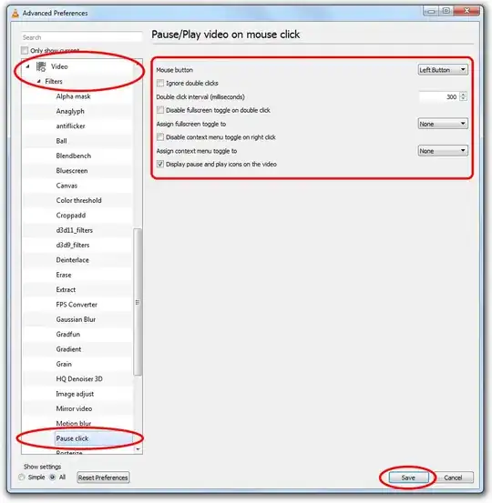

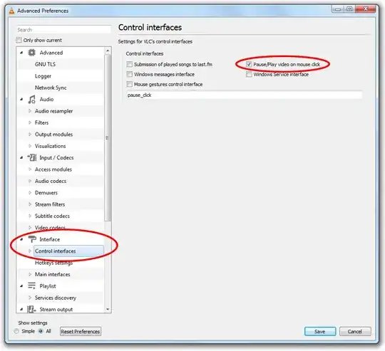

UPDATE on some links posted under this question.
Nurupo's vlc-pause-click-plugin plugin — already mentioned, now fully implements the desired feature (unlike the addon also mentioned here and comming with a requirement of manually enabling it each time, which made it an improbable solution).
The vlc-pause-click-plugin is cross-platform and works with 2.1, 2.2, 3.0 and even nightly 4.x builds.
Installation depends on the platform.
Some settings are needed after installation under Advanced Preferences
Here, for "Pause click" filter, multiple mouse button choices are available: left, right, middle click, and other options
Right mouse click is maybe the best option (while disabling context menu on right click) in case left-click interferes with DVD menus as some people claimed.
As for the difficulty of installing the plugin and accessing the advanced options (like mentioned under this question), that is probably either caused by not following the installation instructions or by not using the latest versions. (I have enabled this feature without any problems with VLC 3.0.8, 64-bit on Windows, Linux and Mac; on Mac I have also tested versions 2.1 and 2.2, and only the last one didn't work.)

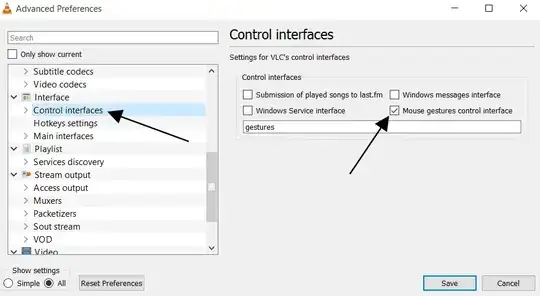

A funny alternative to left-click would be mouse gestures, as indicated here:
- enable mouse gestures in VLC
- select left mouse button
- left-click & a quick left-right (or right-left) movement to play/pause.
The result is real... but you have to avoid other two very similar gestures:
 Move left: Navigate 10 seconds backward
 Move right: Navigate 10 seconds forward
DETAILS:
Go to Tools > Preferences [CTRL + P].
Click on All under show settings to go to Advanced settings.
Navigate to Interface > Control interfaces.
Check the option that says Mouse gestures control interface.
Navigate further down to Interface > Control interfaces > Gestures.
To toggle play or pause: click the mouse button you selected and move left and then right: (Also works if you move right and then left)
But the mouse gestures are not customizable (and you cannot chose to disable some of those you don't need). Therefore, avoid other moves like up and down to avoid making other gestures and trigger other actions like down and then left which quits the player
