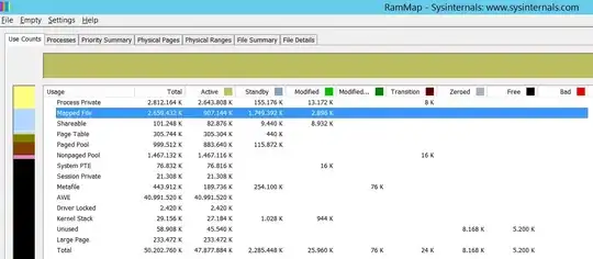

  3. Tried to get more information using tools RAMMap from Sysinternals and VMMap as I suspected that some process leaks memory through memory mapped files, which don’t count to private bytes.
    RAMMap reports following (unfortunately the files under File Summary/File Details are only adding up to less than 300 MB used though 2659 MB reported as active for mapped files):
    Screenshot from rammap

Backing swap storage is a parameter that is consultable. When it's sufficient then over-commitment of memory is not required. My previous answer was not the real explanation.
The conclusion is then that the poster has a real memory leak that doesn't show up in the tools. This usually means that the leak is in Windows or some third-party driver.
Such leaks are very hard to find, and when found they are often in proprietary code that cannot be modified.
As the leak in this case is very small with no performance hit, the problem is mostly just an annoyance. It can be fixed by a reboot every so often. In the poster's case this can even be something as infrequent as once a month.
