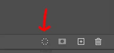

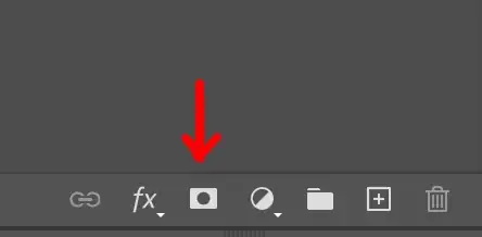

Here is an easier workflow in newer versions of Photoshop:
  1. Go to the channels tab, and select the channel that represents what you want to turn into alpha
  2. Click the "make selection" button at the bottom of the channels palette: a close-up of the "make selection" button
  3. Go back to your layers tab, and click the "make layer mask" button: a close-up of the "make layer mask" button
And now you have a layer mask!
