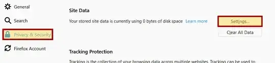

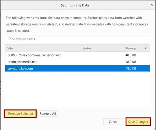

Looks like they might of changed a few things. I found the following:
  1. Menu -> Options
  2. Privacy & Security -> Site Data -> Settings
  3. Highlight the Selected Site and select Remove Selected
  4. Select Save Changes
  5. Finally click Remove
Settings Dialog Remove Selected Dialog Confirmation Dialog

  • I could be wrong but it looks like this option only selects sites that have stored temporary data. For ***those*** sites, yes, it clears cookies and everything else. For a site that has ***not*** stored temporary data, it doesn't appear in the list so you can't just clear cookies. However! If you Clear All Data, it does get all sites somehow. Ugh - as I just did while entering this text. I think this specific feature needs some more testing. – TonyG Feb 19 '18 at 20:53
  • Thanks. Works perfectly. – Dani-Br Aug 15 '22 at 14:23
