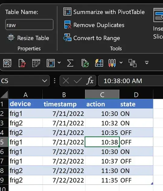

Suppose your table is called 'raw':
Select any cell in the table and Use Data>Get & Transform Data>From Table/Range.
This will open the Power Query Editor with your new query:
Change the data types of "timestamp" to 'Date' and "action" to 'time' by clicking the icon in the top-left of the column header.

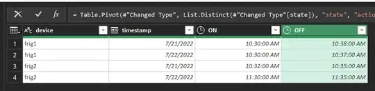

You should now have one row per device/date:

    @LievenKeersmaekers I see what happened now. I pasted your data into my spreadsheet and used text to columns. I guess it should've been timestamp with a date/time and action should be ON/OFF. Oh well, I guess the gist of the answer is still OK :) – FlexYourData Jul 22 '22 at 16:21
