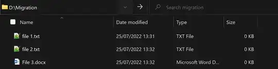

They all have the same name, date and size: enter image description here d:\migration

I can't find a difference! (The time is 2h less than what it displays on my Windows Explorer but it's consistent, so I think this is not a relevant detail). They are clearly considered as different by robocopy and I don't know how to find out the difference or why it does see them as not similar.
When I do the same command on my two local folders robocopy d:\migration d:\migration2 /l /ts /nc /ndl /njh /njs no result is coming and this is good because there is not the switch /is which stands for "Includes the same files.". Even without the /is, it displays all file infos on the network / local folder command. They are not the same for robocopy... but why?
