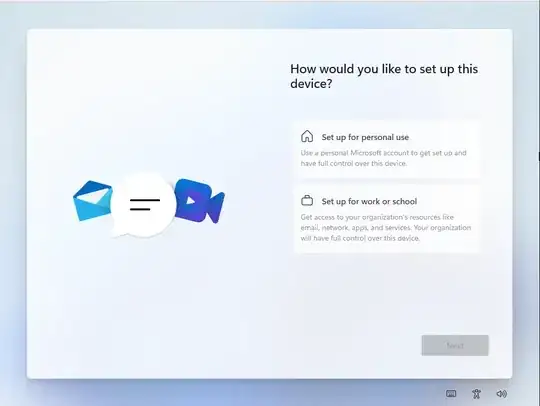

I am expecting to receive a new Windows 11 Home laptop that I would like to join to a company Azure Active Directory, and log in with a corporate account.
I understand that Windows 11 Home does not support Azure AD join, but I have a Windows 11 Pro key available.
I know that I can sign in with a personal Microsoft account (or create a local account), upgrade windows, join the device to AD and then switch to logging in with a corporate account. I would like to know:
Is it possible to achieve the same without needing to sign-in with a non-corporate account or create a new local account?
In the OOBE, you can press SHIFT-F10 to open a console. I believe that Changepk.exe can be used to upgrade from Home to Pro given the right key. Will this work from the command line in the OOBE? It would save a lot of faff with unnecessary local accounts.

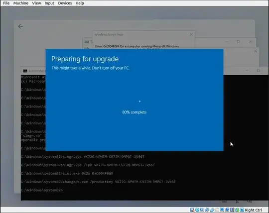

I installed Windows 11 Home into a Virtual Machine and tested this using the Generic Keys from this website, this is what I found to get to the steps above:
  • Running changepk.exe /ProductKey VK7JG-NPHTM-C97JM-9MPGT-3V66T (Key for Windows 11 Pro) brought up the "Preparing for Upgrade" dialogue but then failed with Error Code 0x80070490
Windows Upgrading
Failed to Upgrade Error Code 0x80070490
  • I also tried slmgr.vbs /ipk VK7JG-NPHTM-C97JM-9MPGT-3V66T. This errored with 0xC004F069 and said to run SLUI to get full details. enter image description here
  • I ran slui.exe 0x2a 0xC004F069 and it said enter image description here
  • However, I then ran slui.exe /upk to uninstall the Product Key, and then tried changepk.exe again, after rebooting the OOBE was now for Windows 11 Pro and I could create a local user and domain join. CMD showing windows version to be 11 Pro. Windows 11 Pro signup page.
