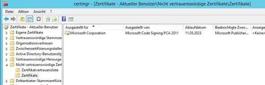

EDIT: For some reason it seams that the signature of Microsoft is no longer trusted: Bestätigung Möchten Sie diese Aktion wirklich ausführen?
Ausführen des Vorgangs "Update script to latest version" für das Ziel "HealthChecker.ps1".
[J] Ja  [A] Ja, alle  [N] Nein  [K] Nein, keine  [H] Anhalten  [?] Hilfe (Standard ist "J"): J
WARNUNG: Signature is not trusted by machine as Valid, status: NotTrusted.
WARNUNG: AutoUpdate: Signature could not be verified: C:\Users\MartinAdmin\AppData\Local\Temp\HealthChecker.ps1.
WARNUNG: AutoUpdate: Update was not applied.

  • For some reason the signature of Microsoft seams no longer to be trusted. Where can I find the "untrusted" signatures? – xMRi Aug 15 '22 at 11:11
The problem was that the Microsoft certificate was placed in the Untrusted publishers.
After removing the certificate form the untrusted publishers I was able to launch all scripts as before.
