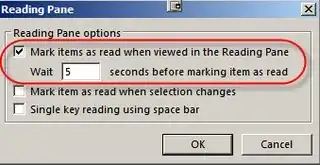

The best workaround I have found for Outlook 2013 is to configure the Reading Pane like this:
  • Check On - Mark item as read when viewed in the Reading Pane (wait 5 seconds)
  • Check Off Mark item as read when selection changes
Reading Pane 5 seconds
This gives you 5 seconds to select a different e-mail before the first e-mail is marked as read.

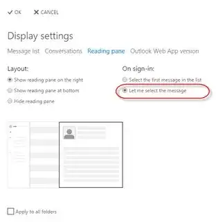

Outlook for Web Access actually has a setting to not select the first e-mail when opening a mailbox, but this feature is not available to Outlook desktop client:
OWA Display Settings
