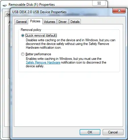

I'm working on an embedded computer in kiosk mode, where the users can insert an USB flash drive.
Even if I add a "Eject USB storage device" button in my app's GUI, often, some users won't use it and unplug their device directly.
How can I configure Windows such that all USB flash drives inserted in the future won't require "Eject"?
(Even if the transfers are slower, it's fine).
I know that once a USB flash drive is inserted, we can set this setting for this particular device, and uncheck these 2 checkboxes:
but how to make this setting for all devices that will be plugged in the future?

I may have overthought this question.
Quick removal seems to be the default on both Windows 7 and Windows 10. I just tried by inserting a flash drive:
I wonder if it's the default for all USB flash drives? Or if USB2 / USB3 will change anything?
(Remark: Then why did we all take the habit to click "Safely remove..." in the tray notification icon if quick removal is the default?)

  • Microsoft has announced this change for Windows 10, but it's possible that it was quietly back-ported to Windows 7. Better test with several USB devices of various type (sticks, disks) that you never used on this computer. – harrymc Oct 18 '22 at 12:57
