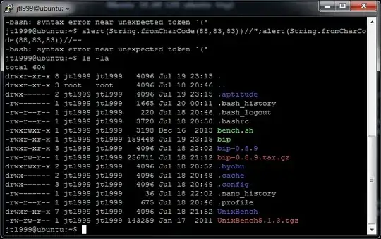

When I was trying to install rust on this Linux machine, it worked (though it did say the $HOME is not the same as euid derived home). I ran the script again (the standard rustup.sh script), this time using -y, and it installed just fine. But when I tried to make a new project, and run it, it claimed that it was not able to find Cargo.toml even though it was in the correct directory.
Screenshot:
Screen capture of the terminal
Things of Note:
  1. The root is simulated using proot
  2. I did run source "$HOME/.cargo/env"
  3. The euid-derived home is /root
  4. I did not use sudo during the install
  5. Regular rustc works when compiling the source
  6. When I direct it to the exact path of Cargo.toml, it says that it cannot find the target directory.
  7. strace dose not work on this machine.
