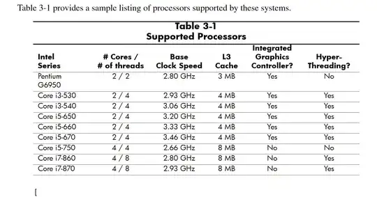

According to the HP tech specification here http://h10032.www1.hp.com/ctg/Manual/c02034672 That processor should work. enter image description here
The error code states video as the processor you have purchased does not have video capibilities built in - The 8100 SFF does have the ability to add a video card via the spare pcie slot - half height video cards should fit.
