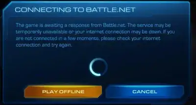

I am able to surf the web and my LogMeIn client is not reporting any errors, but I cannot connect to Battle.net or Steam. (I can still visit Battle.net and Steam via my web browser.)
I was actually logged into BOTH of these services earlier this morning, but now they will not connect. (For those who do not game: these services are unrelated and hosted by two separate companies.)
Steam is temporarily unavailable, please try later The game is awaiting a response from Battle.net. The service may be temporarily unavailable or your internet connection may be down. If you are not connected in a few moments, please check your internet connection and try again.
