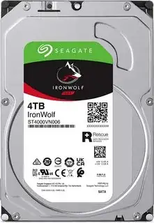

I have measured the temperature of my new HDD, which is currently lying on the desk, doing backup and waiting for the enclosure to arrive.
Hot disk under the sticker
Temperature-wise, there is a huge difference between an exposed area of the disk and the one under the top sticker, ca. 14 ˚C. Should I peel the sticker off? Could that increase the disk's longevity?
The disk is a Seagate ST4000VN006. The disk with the sticker looks like this:
One side of the hard disk drive, with the sticker. The sticker includes the text "4 TB. IronWolf. ST4000VN006."
(image sourced from Amazon)

    The heat is coming from the disk - so ... the sticker is acting as a heatsink? – Journeyman Geek Mar 05 '23 at 00:32
  • 50
    What you're seeing is a difference in the coefficient of thermal reflectivity of the IR device. There's a chart "out there" presenting the necessary adjustment for various materials. – fred_dot_u Mar 05 '23 at 01:23
  • @fred_dot_u made an excellent observation. Is the label much hotter to the touch then the disk? – davidgo Mar 05 '23 at 01:32
  • "*lying on the desk*" -- Placing a HDD on a desktop is a bad idea. Any vibration and/or shock can be easily transmitted to the drive. See https://superuser.com/questions/1510488/solution-for-mounting-hard-drive-better-on-desk-to-prevent-sata-cable-wear/1510530#1510530 – sawdust Mar 06 '23 at 00:19
    Put your finger on both parts - does the label feel 15 degrees hotter than the bare metal ? – Criggie Mar 06 '23 at 01:38
    @Criggie I don't think that will work reliably. We don't feel how hot a thing is, but how quickly it's transferring heat. That's why metals feel cold at room temperature but plastics don't. – gronostaj Mar 06 '23 at 05:33
    You should use a proper thermometer (one that you bring into *physical contact* with the item) and neither a thermal camera nor an IR thermometer if you actually want to measure temperature. – AndreKR Mar 06 '23 at 19:04

You may not have noticed this but stainless steel is kind of like a mirror. If you point your infrared camera at a mirror, you mostly see the temperature of the reflection.
If the drive really was 10 degrees hotter under the sticker the thermal image would show the temperature spreading beyond the perimeter of the sticker.
Apply a coating to the metal part that is black in the thermal infrared and then you'll see a truer picture. I have heard that dry-erase marker works well.
If you want better cooling, stand the drive on its long edge. If you want to know how hot the drive is, there's an ATA command for that.

    Most thermal cameras have a setting to correct for emissivity, either as a value or as a type of surface finish/material, but bear in mind it will only be correct for one type of surface at a time. – matja Mar 05 '23 at 19:16
    Another clue is the corners of the drive. They're painted black, except for the round post that sticks up slightly. The top image shows the painted portion glowing as brightly as the sticker, with the unpainted portion dark. Those are both the same continuous piece of metal, so a temperature delta that large should instantly be flagged as dubious. – bta Mar 07 '23 at 02:29

No you shouldn't and it won't. Taking it off may even void your warranty, and even if it doesn't it will make unnecessarily complicate a warranty claim.
Those stickers are on top of every HDD since they first appeared, and I've never heard even a rumor of a single instance where the sticker would've caused heating or other issues. I've got 2 of those in a RAID box, never had a failure of any kind.

This is due to emissivity: for the same actual surface temperature, different materials will emit different amounts of infrared energy. Emissivity coefficients can vary widely: from lows like 0.01 for polished silver, up to 0.95-1.0 for leather.
Infrared thermometers and cameras will assume a particular emissivity. The default is usually reasonable for household materials (for example, the FLIR One's "Matte (Recommended)" is 0.95), but may be configurable. If you're just looking for hotter or colder spots on uniform material, it's not critical to have the right emissivity setting - relative differences will still show up. If you are trying to measure actual temperatures, you must have the correct emissivity setting for the material you are looking at.
Also, the one setting will apply to all the pixels in the sensor, even if you are looking at multiple materials in one scene with completely different emissivities. This is what's happening in your demonstration - your camera is likely set to use a material emissivity coefficient of 0.9 or 0.95 which lines up well with such sticker materials as polypropylene (0.97) and PTFE (0.92). By contrast, the metal cover (polished metal, probably stainless steel) may have an emissivity somewhere in the 0.1 - 0.66 range (depending on the specific alloy).
This means that your camera is receiving significantly less IR from the metal vs. the sticker, even if the actual surface temperatures of both are exactly the same. The post-processing done by the camera software with a single emissivity value comes up with completely different results, because the two areas do not have the same emissivity.

In addition to what others have said, your camera only shows temperature up to 40 degrees centigrade- just over 100 degrees Fahrenheit, or a little warmer than body temperature. According to Seagate docs, your hard drive can operate continuously at 60 degrees centigrade, and can tolerate 65 degrees centigrade.
You're significantly far from the point where you need to be concerned about overheating and heat effects.

    Cooler is *not* better. [Google's hard drive study](https://static.googleusercontent.com/media/research.google.com/en//archive/disk_failures.pdf) found that hard drives last longest when operated between 35C and 45C; drives running cooler than 20C failed almost five times as often as ones running warm. – Mark Mar 06 '23 at 04:29
Not only are you not getting an accurate reading as others have pointed out, but you're also conflating a higher reading on the camera with a higher internal temperature. Even if you get an accurate reading the camera is only ever going to show you surface temperature. Since you want the internal temperature to stay cool you actually want any internal warmth to easily transfer to the surface, which means that the surface temperature should be warmer.
Try taking a picture of yourself wearing a heavy coat vs. wearing a thin shirt. The surface of the coat will be cooler than the surface of the shirt (if you don't have a camera you can just feel it with your hand). If you're too hot and want to cool off, would you rather be wearing the coat (cooler surface temperature) or the shirt (higher surface temperature)?

Answer: No - the label is doing very little, the drive is designed with the label in place, so it won't cause any issues.
Also consider that on your desk there is minimal airflow. In a PC case there should be some air flowing past the drive all the time. It is arguably worse for your drive to be on the desk than in a case.

It is also affected by the "emissivity" surface, with chrome and polished surfaces looking much colder than they really are. The best easy solution is to stick a small square of paper tape to the item you want to measure, and then wait till it comes up to temperature before measuring.
You can also check the drive's SMART stats to see what it thinks its own temperature is, and compare that with the IR reading.
