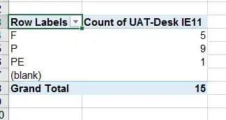

I've done a powercfg /batteryreport but it is not of any use, as it will not track the battery discharge: Battery Report On the above image, the BSOD occurs 2023-03-23 12:41:00, just before the PC is powered on on AC, with 1% battery
