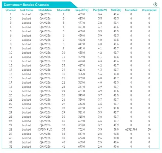

So I tried to bend the coax cable and putting the modem as far away from the circuit breaker and got a VERY DIFFERENT result. After 24 hours, my modem shows 0 errors except the 732MHz OFDM PLC band which still has a lot of corrected errors, but only 0.00006% of them uncorrected. See screenshot below:
the stats at the second location

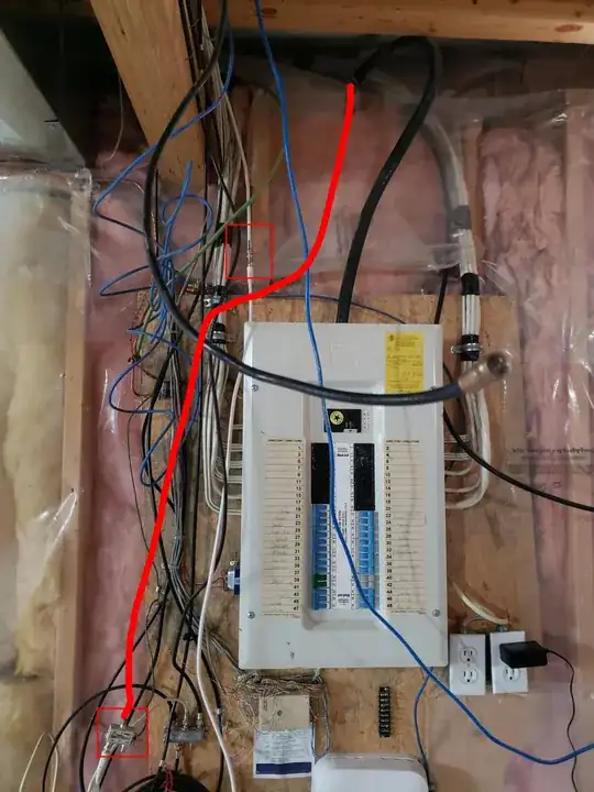

Here's a picture of the circuit panel and the current location of the modem. The red line was the cable path before the move (modem was hanging in the air). picture of the circuit panel and the modem
I noticed that in the new location, the power level and the SNR is a lot better, which may explain the improvement in errors. And in between the two locations, I have disconnected the cable from the modem to perform some other experiments, but I think I screwed on the cable to the modem with equal tightness.

Addendum. Before I moved the modem to the basement, the original location of the cable is marked by the red line, and the cable from the outside terminates in a splitter that is also grounded. See picture below (red line traces where the outside cable used to go): original cable path
A short cable from the splitter extends it upstairs, through a coupler (second red box above), terminating in a wall jack in a room directly above the current location of the modem (so it is a short cable). Another cable connects the wall jack to the modem inside that room. With this set up, the errors in most channels were better, but still significant. See screenshot below: the stats when modem was upstairs the splitter
I thought the splitter and/or the multiple cable segments was the culprit, so I bypassed the splitter by moving the modem to the basement and connecting the outside black cable directly into the modem. But several users commented that it's the modem's proximity to the power panel that is the culprit, so what I'm going to do next is to move the modem back upstairs and connect the outside cable directly to the coupler as far away from the power panel as possible.
