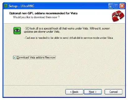

If you install UltraVNC as a service, you can see the UAC notifications and press the buttons, on Windows 7 and Vista.
Also tick the "Download Vista addon files" option, when installing.
