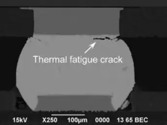

    This is the best answer, however there is one thing no one has spoken about. When you apply power, the chips heat up and expand. Switch off and they cool down and contract.This will induce weaknesses in the tracks which could fail. This was explained to me when I worked at the DEC chip manufacturing plant in Scotland. – Bib Aug 30 '23 at 18:57
  • @Bib, excellent comment! not uncommon: SSD failure due to crack in some solder joint. – Joep van Steen Aug 30 '23 at 21:10
  • There's no need to effectively power-on/power-off a drive to have temperature variations: alternaning between heavy workloads and idle state have the same effect. And this happens much more frequently... – PierU Aug 30 '23 at 22:05

TL;DR
Read about Thermal Cycling Failure in Electronics and check out this cool image of thermal fatigue in solder.
