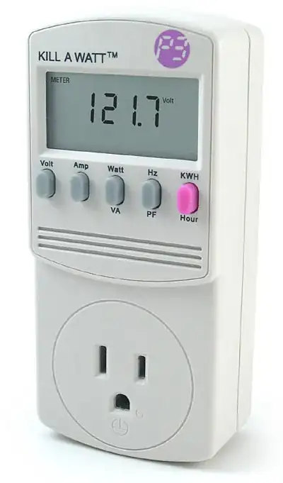

I think the best thing you can do is buy yourself an electricty monitor such as a kill-a-watt - they are amazing and you will get addicted to seeing what costs what! (or should I say watt costs watt!) alt text

    +1 because nothing can beat a real measurement instrument. – AndrejaKo Aug 30 '10 at 18:23
  • @AndrejaKo I bet a lot of money can ;) – Pylsa Aug 30 '10 at 18:27
  • @BloodPhilia But without a precise measurement instrument, how are you going to know if you actually do have money and assuming you do have money, is the amount of money small, medium or large. :) – AndrejaKo Aug 30 '10 at 18:51
  • @AndrejaKo A large amount of money could always buy you an ever MORE SO PRECISE instrument :D Beating this one! – Pylsa Aug 30 '10 at 18:54
  • @BloodPhilia However, you would first need an instrument to measure amount of money you have in order to be able determine that you have enough money to buy more precise instrument. There :D! Anyway this is very childish and we should be ashamed for making such pointless comments. – AndrejaKo Aug 30 '10 at 19:09
  • @Andre Omg, you're right! And this may be childish, yet sometimes it's just fun and should be allowed to :) Helps release all the seriousness and get some air! – Pylsa Aug 30 '10 at 19:11
    Kill-a-watt is the way to go. My iron uses more power in 15 minutes than my PC does all day, so it's very informative in unusual ways. – Garrett Aug 31 '10 at 05:09
  • +1 for the Kill-a-watt suggestion, that's a great little device -- although I *almost* didn't give it to you because of that awful "watt costs watt" pun... :-) – Josh Sep 03 '10 at 13:34
