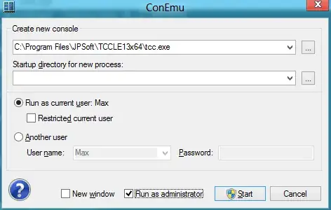

Do you want to try ConEmu? I'm an author of this console emulator. You may run selected tabs elevated, or under specified credentials. And you may specify different palette for elevated consoles (or specified applications).
New tab parameters
