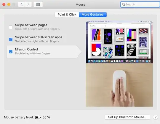

So for macOS 10.14.6 click on the apple menu and go to System Preferences and go to Mission Control click on Hot Corners in the bottom left corner of the window put Mission Control in one of the corners. Take your mouse up to the corner you assigned it to and it will separate the open windows on your desktop out pick what you want on a new desktop and drag it up to the top menu bar. Done you can create as many new desktops as the OS will support. Or swipe up with three fingers on your laptop and drag the application you want on the second desktop up to the top menu bar.
