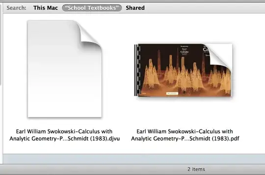

For those interested or for those that like using the terminal on a Mac
I recently asked this question when I found a strange file on my computer whilst trying to come up with the answer to the same question posed by this thread.
First, install homebrew through the terminal with this
ruby -e "$(curl -fsSL https://raw.github.com/Homebrew/homebrew/go/install)"
And then install djvu2pdf, which, by the way, has almost no documentation but works like a charm.
brew install djvu2pdf
Then, navigate to the directory where my .djvu file is stored, and run this command:
djvu2pdf [somebook.djvu]
Since most textbooks have really long names that have spaces in between them, just enter a little bit of the name (enough to make it so there is only one file in the directory that starts with the current string) and then press tab.
It takes a while, how long I didn't figure out, but definitely not more than half an hour, and it will place a new file in the directory that is a pdf version of the .djvu file.

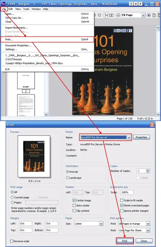

WinDjView and Djview are two open source readers for the DjVu file format.
To convert DjVu to PDF from WinDjView:
  1. Go to File->Open (or press Ctrl+O), browse for the DjVu file you want to convert to PDF select it and click Open
  2. Go to File->Print (or press Ctrl+P) and from the Printer section choose novaPDF. Before creating the PDF file you can customize novaPDF’s settings by using the Properties button and also adjust other printing options
  3. Click on Print and choose a location where you want the PDF document saved

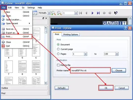

alt text To convert DjVu to PDF from DjView:
  1. Go to File->Open (or press Ctrl+O), browse for the DjVu file you want converted to PDF select it and click Open
  2. Go to File->Print (or press Ctrl+P) and from the Printer name choose novaPDF. In the Printing Options section you can customize the color, orientation and the scaling of the document
  3. Click OK and choose a location where you want the PDF file saved
