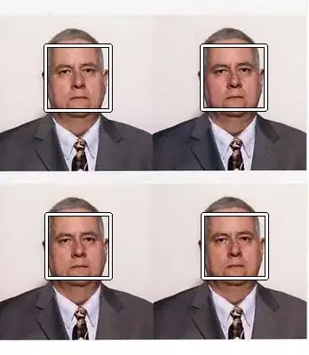

Cropping passport pictures automatically sounds definitely doable. Fixed lighting conditions, always facing forward, consistent image format... I don't think one could ask for more favorable conditions for face detection.
I tried to use facedetect to see the results on your sample image:
raw facedetect output
Passports come in different formats and sizes, so they will be packed on the flatbed of the scanner irregularly, but I assume you will place the pictures always upright. facedetect will give us the centers and size of all the faces. In particular, we can use the size of the face and crop the area around it proportionally. Since passport pictures tend to cover a fixed area of the photograph, it seems to be a relatively safe assumption.

I empirically defined a border area of 60% (in the second line of the script) of the width of the detected face. These are the four images I get:
1_1 1_2 1_3 1_4
which is already pretty good. There's always some white space left at the top, which I was able to remove by just adding "-fuzz 10% -trim" in the convert invocation. Here's the result of the first image after that:
1_1 trimmed
Not too shabby for a quick script, and there's plenty of room for improvement. For instance, most passports use a portrait orientation, so having a different vertical/horizontal factor (usually 1.3). Also, faces tend to be slightly moved upward (by 1.3 probably). Correcting for those would result in a better crop, avoiding the need of trimming the white space at the top entirely.
It would be nice if you could post (even privately) a sample flatbed scan to test this script against some real output.
