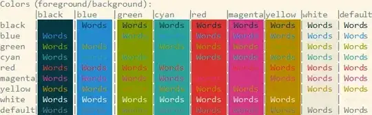

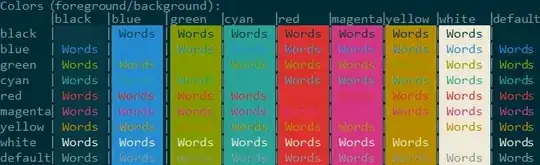

The default PuTTY color scheme is known to be tough on the eyes, I would recommend taking a look at Pretty PuTTY, Solarized PuTTY, or Solarized & Modern PuTTY for better color settings.
Screenshot of Pretty Putty:
Pretty PuTTY Light Light color scheme
Pretty PuTTY Dark Dark color scheme
