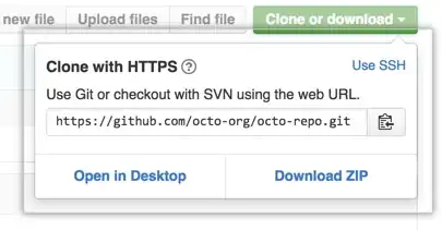

use SSH
To prevent GitHub asking for the password while pushing, ideally you should use SSH (git@github.com:...) instead of HTTPS URL (https://github.com/...) and add your SSH key to your GitHub account. See: Which remote URL should I use?
GitHub - Clone with SSH
a credential helper
Otherwise if you really need to use HTTPS, to cache your GitHub password in Git, you should use a credential helper to tell Git to remember your GitHub username and password every time it talks to GitHub.
  • Mac: git config --global credential.helper osxkeychain (osxkeychain helper is required),
  • Windows: git config --global credential.helper wincred
  • Linux and other: git config --global credential.helper cache
