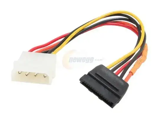

I've found adapters, but they go the wrong way: old power supply to new drive.
molex 4pin male to 15pin SATA power cable

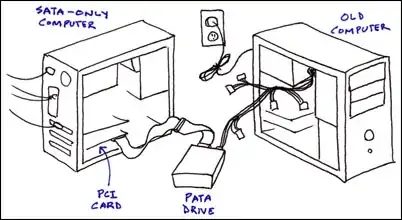

I ended up Frankensteining two computers together. I put a PCI PATA card in the new machine for the data connection and got power from a different computer. Ugly.
PATA drive in a SATA computer

    I can't help noticing the computer on the left is not plugged in :) You could also get one of these usb -> PATA adapters and just use the molex from it, worked nicely for me – Colin Pickard Dec 01 '08 at 16:22
    Well... let's assume there's another power outlet to the left. :) – Zack Peterson Jan 06 '09 at 14:00
    This is really bad if there's a ground loop. I'm surprised you didn't fry something. – Broam Oct 19 '10 at 15:38
  • Nice to see such a solution, grounding shouldn't be a problem as both PC's PSU's are grounded and the voltages in question are very low... – HaydnWVN Jan 06 '12 at 11:25
  • @HaydnWVN a decade later, but still: that's not how ground loops work; the ground potential in one outlet is not necessarily the same as on the other (it actually almost certainly isn't), so your black IDE power cable now carries all the current necessary to balance them. Depending on how large the load is that caused the ground imbalance, this can be microampere – to wire-melting amounts. – Marcus Müller Jan 09 '23 at 16:21
  • @MarcusMüller but in what % of applications would anyone performing this task have the 2 devices linked to 2 different power distributions with enough of a differential to be that dangerous? I would hope quite low risk - especially if you consider the lengths of the internal cables meaning these devices are next to each other. But it IS something to be aware of for those times it may happen. Maybe the answer needs a disclaimer adding. Decade later+1y replied! :) – HaydnWVN Jan 11 '23 at 10:34
    @HaydnWVN that's a fair remark, but I was especially worried because Zack Peterson chose to draw the supply lines *not going to the same outlet*. Regarding percentages: It used to happen to me a lot that when I ran Ethernet cabling from my PC in the next room to my PC in my old-building living room, and the water heater was on, there was a very short arcing when the cable shield touched the PC chassis. So, not *that* rare. Old building wiring is … weird, and bad. – Marcus Müller Jan 11 '23 at 10:40

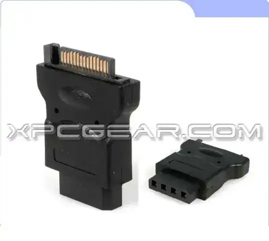

Here's a power adapter that goes the right way...
SATA 15-Pin Power Male Connector / Adapter / Converter to Standard Molex 4-Pin Power Female for Hard Drives and Optical Drives
Great for those with new Dell, HP, Compaq PCs that do not include any 4-Pin Molex connectors on their Power Supplies!
If you need to use an older IDE hard drive or optical drive with a new SATA power supply, look no further than xPCgear’s LP4 to SATA power adapter.
http://www.xpcgear.com/lp4satafm.html
