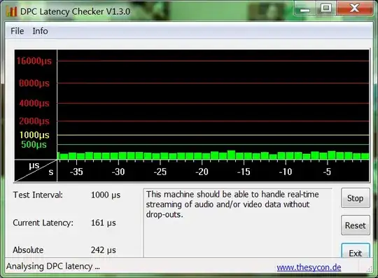

I knew that DPCs are code being run inside a driver; the challenge was to figure out which driver. I turned to DPC Latency Checker, which showed me just how bad the latency was:
screenshot of DPC Latency Checker
DPC Latency Checker suggests going through devices in Device Manager, and disabling non-essential hardware one-by-one (e.g. network card, sound card), hoping to isolate the buggy driver. (If you disable a device, and the DPC latency suddenly drops: you've found your culprit!)

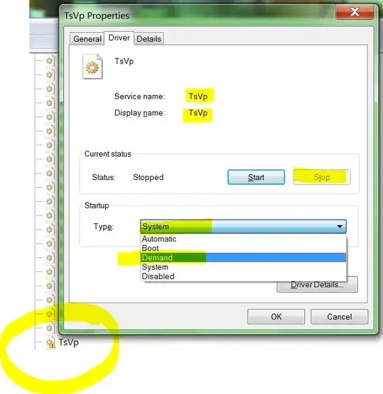

Using Device Manager, I can disable the service that hosts this driver. First you have to Show hidden devices, then expand the Non-Plug and Play Drivers node:
screenshot of device manager
Finally I could stop the driver service, and I changed it's startup mode from System (meaning the driver is an essential part of Windows, and Windows cannot boot without it), to Demand (meaning I can start the driver when I want to):
Stopping the driver service immediately fixed my DPC latency:

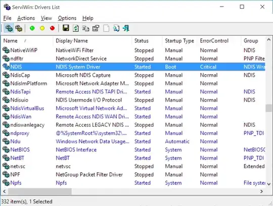

Fortunately, NirSoft has created a replacement. ServiWin lets you see, stop, and start all services (even the ones Microsoft decided administrators should not be allowed to see):
screenshot of ServiWin

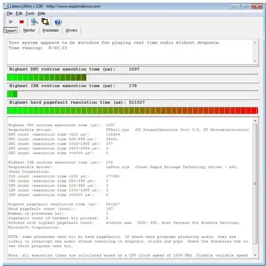

PROGRESS REPORT
The best tool I've found so far is LatencyMon, which basically does everything that the preceding two tools do, without making you think. The download page asks you to register via email - but nothing happened for me when I did that - but you can scroll to the bottom of the page to download anyway.
alt text
