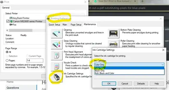

For Canon MG3600 I could find an option to select only the "Color Cartridge". From the print dialog, select Properties > Maintenance > Ink Cartridge Settings > Color Only.
I think it make color composite to give black, as the result was indeed black although I my black cartridge is empty.
Rami Alloush

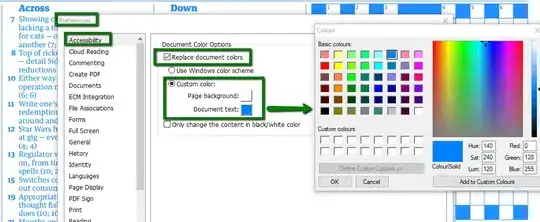

Some PDF readers let you do it as an Accessibility setting under Preferences.
For example, Foxit Reader does it here:
I read somewhere that Adobe reader has a similar setting.
