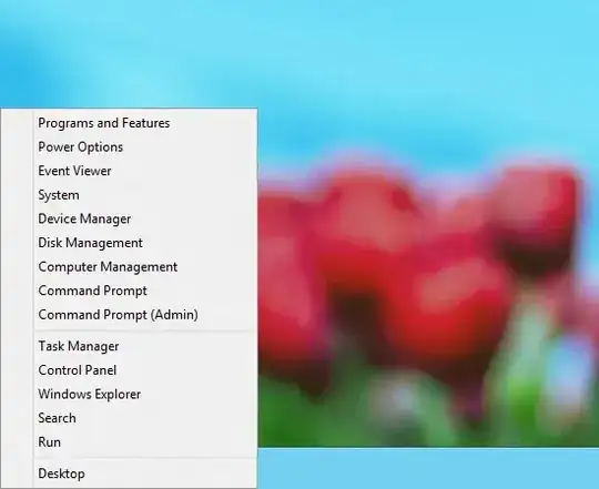

20
On Windows 8/Server 2012, if you want to run cmd as an administrator you can just use Win + X. Then in the popup menu you can run cmd through the Command Prompt (Admin) option.
See the screenshot: screenshot

  • I tried Win+X in a Win7 VM, and it did nothing. Win+R brings up the Run dialog, so the Windows key works fine. Is this for some other version of Windows, or is it provided by some additional utility or controlled by some setting? – user May 10 '13 at 20:17
    Like he said, Windows 8 and Server 2012. The Win+X shortcut is sort of a consolation for people that missed the Start menu. – Steve Howard Sep 06 '13 at 23:30
    +1 for Win+X! Nice hacky shortcut for Win8+ (also works in Win10). – rustyx Dec 14 '15 at 14:12
