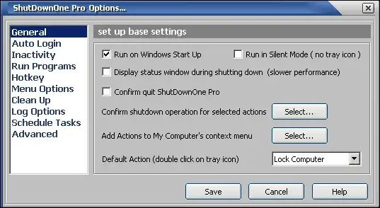

ShutDownOne Pro is a tray-based system utility that can automatically perform various frequently-used operations such as shutting down, restarting, switching power off or locking your computer.
Note: ShutDownOne Pro can also turn on your computer at specified time. It can run programs before performing operation or after windows resumes from restart as well as from sleep mode.
