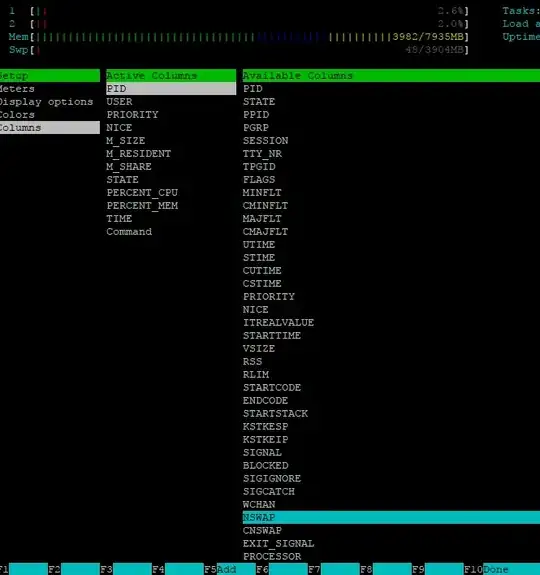

With htop v1.01, I pressed "S" to add NSWAP column instead of "F2" (as Gilles suggested), then Columns > Available Columns > and F5 to add it.

    I have htop 2.0.1 and I don't see the NSWAP option :( – Adam Jul 05 '18 at 13:55
    @Adam The maintener doesn't want to show this column anymore due to no reliable way to get this information; see [Why doesn't htop feature a SWAP column, like top?](http://hisham.hm/htop/index.php?page=faq) – Genjo Jul 09 '18 at 14:35
