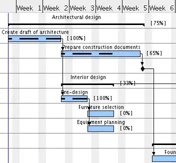

The free GanttProject (Java) can make some nice looking timelines.
alt text

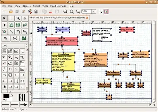

Dia is a program to create diagrams on Linux, it's similar in practice to Visio.
Dia is roughly inspired by the commercial Windows program 'Visio,' though more geared towards informal diagrams for casual use. It can be used to draw many different kinds of diagrams. It currently has special objects to help draw entity relationship diagrams, UML diagrams, flowcharts, network diagrams, and many other diagrams. It is also possible to add support for new shapes by writing simple XML files, using a subset of SVG to draw the shape.

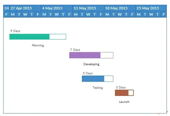

You could use Creately or Creately Desktop to help you draw Gantt Charts or timelines.
Lot less time fiddling around as the timeline and due dates can be just put in and the unit of time can be configured. Then just draw the bars or lines.
Can export as vector to be put into LaTex I suppose.
Creately Timeline Diagram
