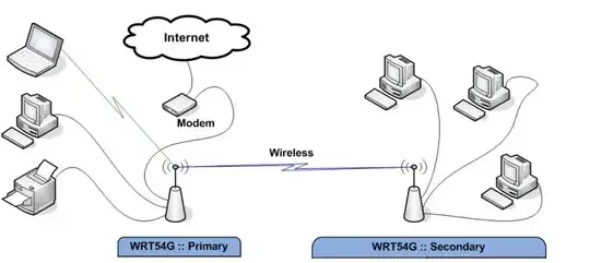

If this is the setup you're looking for:
do the following:
  1. Do a HARD reset on your router.
  2. Connect a cable from your computer to the LAN port on your router.
  3. Set your computer to a static IP address of 192.168.1.9
  4. Set your browser to 192.168.1.1 and open the dd-wrt webgui.
  5. You should be asked to change your password and username. Carefully type these in. If you aren't asked for a password and username, do a hard reset, this time doing it properly! Hit change password.
  6. Go FIRST to wireless, wireless security and enter the security type and key that matches your primary router.
  7. Hit SAVE, (or APPLY if you wish to)
  8. Go to the wireless, basic settings page and change the wireless mode to Client Bridge. Your wireless network mode, channel and encryption should be set to the same as the primary router.
  9. If you are using N only or Mixed with N, set your wireless channel width to match your primary
  10. Set the wireless network name to exactly the same as your primary router. Make sure spelling and capitalization match.
  11. Hit SAVE at the bottom. Then hit APPLY.
  12. Check to make sure all the configurations, including the mode, saved and the mode is still client bridge. If any changed, fix them, and save again.
  13. Go to Setup, basic setup and enter a router Local IP address of 192.168.1.6. (Presuming your primary router is on the 192.168.1.x subnet. Client bridge must match the subent of the primary router) Leave subnet mask at 255.255.255.0.
  14. Set the Gateway IP to your primary router. (Likely 192.168.1.1)
  15. Leave Local DNS blank
  16. Check Assign Wan port to a switch, if you wish to.
  17. Change your timezone and DST to match where you are.
  18. Hit Apply.
  19. Set your browser to 192.168.1.6 and login to your router
  20. Goto Security, Firewall. Under Block Wan Requests, uncheck everything but "Filter Multicast" (Leave Filter multicast checked).
  21. Hit Save
  22. Disable SPI Firewall
  23. Hit Apply.
  24. Go to setup/advanced routing and change the operating mode from "gateway" to router. 25. Hit Apply.
  25. Set your computer back to auto IP and auto DNS.
