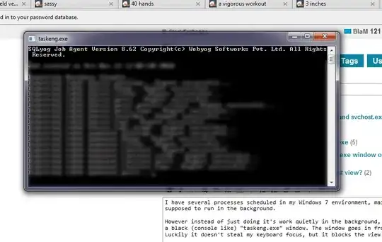

I have several processes scheduled in my Windows 7 environment, mainly for backups, that are supposed to run in the background.
However instead of just doing it's work quietly in the background, the task scheduler pops up a black (console like) "taskeng.exe" window. The window goes in front of all other windows. Luckily it doesn't steal my keyboard focus, but it blocks the view on everything.
taskeng.exe
Is there a way to avoid this window - or at least have it appear in the background without stealing my VISUAL focus?

Apparently you have installed SQLyog MySQL GUI, which has scheduled the execution of the SQLyog Job Agent. It looks like it is a console application that does not try to hide itself.
You should look in the Task Scheduler for a task referring to SQLyog and correct its entry. If it is a cmd call, try to add /b to the parameter list. If it is just a call to an executable, you could correct it in view of this answer of mine.
If you have troubles locating this entry, use autoruns to find how SQLyog is started. You could also use regedit to search for all mentions of SQLyog or whatever is the name of its installation directory.
You could of course also uninstall SQLyog MySQL GUI, if you don't need it.
If you have not installed SQLyog MySQL GUI, then your computer might be infected. You could use Process Monitor to verify when the popup appears, to see whether it is the taskeng.exe from system32 or one of the Look alikes of Taskeng.exe.
