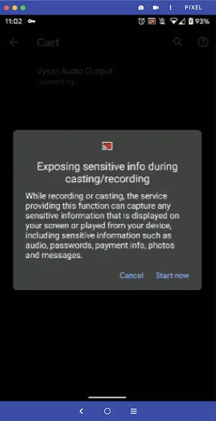

Vysor for Android to Mac audio
Vysor works by enabling Chromecast to 'cast' the device's audio and video from the Android device to the Mac. The setup works so far. I've tested this as a proof-of-concept. More testing is needed for the reliability of the connection over a long period of time.
Setup
  1. Vysor overflow menu > Toggle Audio
  1. Select Vysor Audio Output > Accept warning by selecting Start now.
