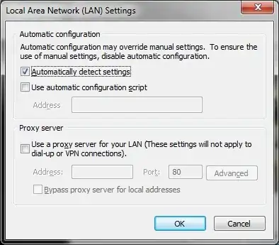

The thing that both programs have in common is encryption. Both use encrypted communication. I'm not an expert on encryption, but I would expect that it might mess things up a bit if your computer is set up to use a proxy or if some malicious software is forwarding your internet traffic through a malicious server. Are you able to log into ssl encrypted websites without having to accept new certificates?

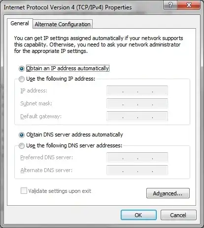

Make sure your DNS settings are set to known good DNS servers or DHCP. alt text
Make sure you are not set up to use a proxy server. (In internet explorer, go to tools->Internet Options->Connections->LAN Settings)
