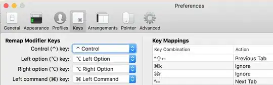

I map Command-r to "Ignore" in the iTerm key mappings.
Screenshot of iTerm2 preferences dialog
